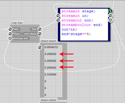

Re: Prototype - Free running poly oscillators
You almost got it mate! It seems it does not yet want to give each voice its own correct phase value, it seems they are repeated thus causing that nasty flanging phase reset sound.
- uniphase.jpg (39.41 KiB) Viewed 34439 times
- adamszabo
- Posts: 667
Thanks adamszabo I must have overlooked that, I did think it didn't sound quite right.
This is strange and currently cannot see why this would happen.
I'll have to investigate further, only thing I can think of is that them voices are not being detuned although they look like they are.
I'll have another crack at this tomorrow.
Ok I have fixed it
Was such a basic error in the ASM I overlooked it
I have optimized the Shared Mem module by putting the read / write inside the same ASM block, so that such save a few cycles
