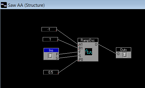

This is how Saw (antialiased) looks in the Macro. RampOsc is the "prim" with a variable number of stages.
My goal is to create an Osc with several (3-4 probably) number of stages that will be modulate-able. So this will let to create so-called morph-effects with a very (I guess) little CPU cost.

You can implement pretty much any waveform in FS. Does the cyan curve in the icon in your picture represent what you are after? Then that would be a piecewise linear curve, presumabely with non-equidistant nodes and possibly with discontinuities, right? I would address alias suppression for such an oscillator using polyBLEPs for the discontinuities and for the kinks.
