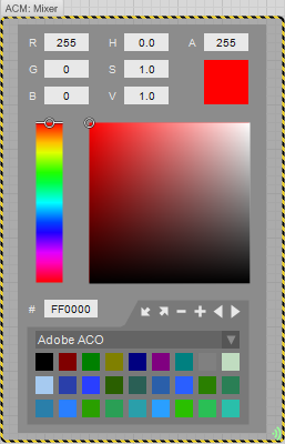

To avoid having to write this a dozen times (yes, I'm optimistic that so many of you will be willing to help), I post it here. It's a user guide/reference
Working with ACM
First add the Mixer to your schematic on the top level. Then add receivers wherever you need them. A color you select in the receiver stays connected to the mixer. Any changes to that color in the mixer are instantly reflected in the receiver.
All number fields
R, G, B control the RGB shares of a color. H, S, V control the HSV shares of a color. HSV is mapped to RGB. # (hex- or webcolor) is the hexadecimal representation of R, G and B. A is the alpha value. All fields interact with each other to reflect changes immediatly.
LMB + {hold}: Change value
DC: Enter value, you can also copy/paste then
Spectrum control
Corresponds to Hue
LMB: Select a hue
LMB + {hold}: Drag through hues
Gradient control
corresponds to Saturation (x-axis) and Value (y-axis)
LMB: Select a shade
LMB + {hold}: Drag through shades
LMB + {hold} + [SHIFT]: Only drag along y-axis
LMB + {hold} + [CTRL]: Only drag along x-axis
The last two always refer to the original spot when first clicked!
Group control
Here you manage all of your colors. Corresponds to the receivers. Whatever you enable here, will be selectable in the receivers.
    Icon bar
    From left to right: Import, Export, Delete Group, Add Group, Scroll one group back, Scroll one group forth
      Import:
      A file dialog opens where you may select either .cex or .aco formats and then the file from which you wish to import colors.
      Export:
      A file dialog opens where you may enter a file name to export the current group to.
      Delete Group:
      Deletes the current group. If it is the last group a new group is created automatically.
      Add Group:
      Inserts a new group before the current group. If you wish to add a new group to the end of the list, press [CTRL] while clicking.
    Group name control
    Give your groups unique names or select another group
      Name field: LMB - Edit color group name
      Popup list icon: LMB - Open the menu to select a group
    Color field area
    Each group's colors are displayed here. Each group consists of exactly one empty color field and unlimited non-empty color fields.
      Empty color field: RMB - Fill with current selected color. A new empty field is added automatically.
      Non-empty color field:
        RMB - Replace with current selected color
        RMB + [SHIFT] - Delete color field
        LMB - Select this color (fills all number fields, the spectrum and the gradient control with this color's values)
      Color field area: Mouse over, then [CTRL], then LMB + {hold} to scroll through the color fields.
Receiver
Appears just like the color prim. To make changes, select the properties. There you are presented with the groups and you select any of the groups and colors.
