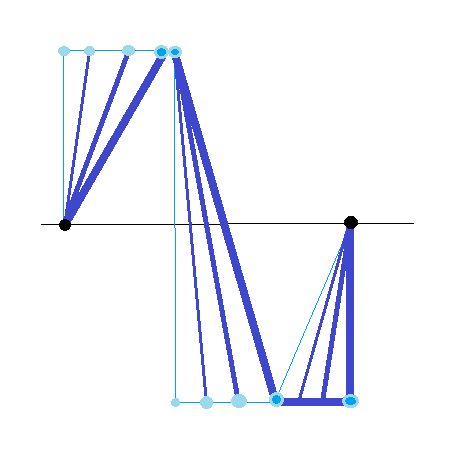

My idea is like this. I've made a rough picture in Paint. Black points are steady (obviously), blue points are moveable in X-direction (horizontal)
Four moveable points can easily give from Tri to Saw and Square with different transition combinations. Also some kind of a "Sync" effect is achievable over this (I've called this Stretch because wasn't familiar about this thing when I've "invented" this OSC).
Of course I suspect that the idea isn't fresh at all :D Maybe somebody already had did this?
