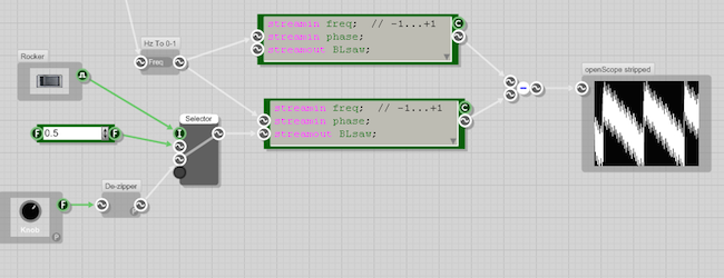

Since I'm the dope without FS, let's do this the other way 'round. Here's a schematic of my situation. With a 0.5 float - perfect square, with a PW control, a saw on acid. Maybe it's not the same saw you guys are using.

The problem in your schematic was a faulty phase implementation :oops: Fix attached.
BLIT PWM less of a mess.osm
(56.98 KiB) Downloaded 1141 times

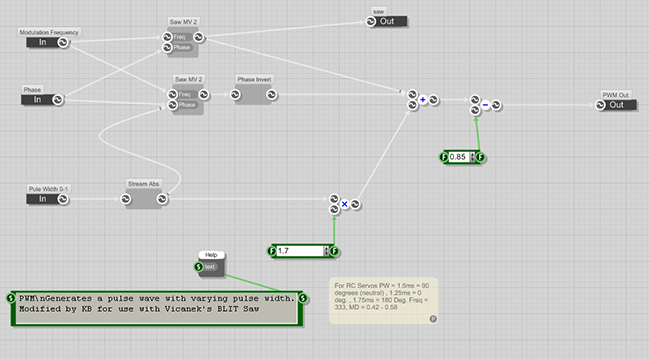

So, I tried your saw with the 'fancy' pwm (stays-centered) method and it didn't work! I noticed your oscillators have a different phase relationship to the stock oscillators. Here's how I modified the PWM to work with your oscs.
Centered PWM wVicnak BLIT Saw copy.png (109.7 KiB) Viewed 28184 times
Does this have DC on the output?
Posts: 1198
Re: Synthmaker bundle
Postby martinvicanek » Fri May 04, 2018 2:21 am
You can easily measure DC by placing a lowpass with sufficiently low cutoff. ;)

Postby k brown » Sun May 06, 2018 5:43 pm
I put a couple of u-he synths on a scope and they don't keep the pulse waves centered with varying width, so probably safe to say it's a non-issue in the real world. On some, the scope in the plugin itself shows the waveform staying centered, so it must be receiving a 'corrected' wave so it 'looks nice' on the scope. I do use the centered, unipolar version in LFOs though, so the pitch stays 'tuned'. It's interesting that there seems to be no consensus regarding unipolar vs bipolar on LFO waveforms in the synth world hardware or software. Dave Smith's LFO waves are all uni except Sine and Tri, none of u-he's (of the ones I checked) are uni, the ARP 2600 hardware - same as Smith's. Same with 'voltage' ranges of LFO waves; Smith's are +/- 5v on the bi-polars, 0-5v on the uni's while others' are 0-10 on unis, ARP Odyssey's are all over the place, etc.
Anywho, thanks again Martin for these and the correction - they sound great and do keep the CPU load at bay.
