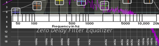

Looks like Hz markers are partly off a bit.

Thanks, this is a stable release candidate though. I said release candidate because I merely have to add the other filters (High Pass, Low Shelf, Band Pass, High Shelf, Low Pass, De-Esser ). To be honest I've been working on the selector. I wanted a custom dropdown menu and arrows from right to left. It's an annoying thing to make, lol.
I was thinking though, the de-esser can only be on one band. Is it a good idea to have it automatically move to the new band if previously selected; Or instead only be available in the menu if Unselected. Kind of a pain the latter. It could just default to a peak after all.
juha_tp wrote:Looks like Hz markers are partly off a bit.
Yes I designed this for 48000 sample rate; I'll make all of the other sample rates so that it matches up. I have other daws so I can test and implement for every sample rate affected. A lot of work; But I've been training to make the "real thing". I knew what I was getting into. This 44,100 I assume?

It dawned on Me that I could set the sample rate to be static; it only goes to a certain level anyways.
Also, there's a bug with presets. I was able to fix the q presets by adding a 1 subtracted by the preset value and created a physical connection to the preset parameter.
That's all well and good but the decibels were trickier. That'll be tough to solve but I am very glad that I got over the hump of crashes. I'd noticed while working on the Stock EQ that the base equalizer code crashes FL Studio when the CPU was taxed by 40% or more. And that of course was My first priority. This new style of bell location and co-ordinates implementation seems to bypass the same phenomenon.
I'm glad of that, and it just goes to show You that sometimes it's worth making it from scratch. So, tonight I'll get that done; Prepare a custom dropdown menu using rounded rect primitives and mouseover, and so on. I'll add: default, peak, low shelf, high pass, band pass, high shelf, low pass, and de-esser.
I noticed also an issue when initially clicking the bells that they change in location and I'll troubleshoot that too. But no crashes, thank God.
And BTW, the method I used for X-Y Co-ordinates and Parametric EQ Bell manipulation is CCO, I made that from scratch. You'd probably want to mention Acrobat and Troggludite though, Exonerate, and MyCo as well; For I'd used some of their stuff (and so did the stock primitives); or sometimes at least as references.
But this Parametric EQ as a whole is CCBY. I decided to Re-add KG_Is_Back's Ruby FL Studio Style analyzer due to the fact that it is stalwart. I liked the hanning/nutulya analyzer by MV, Trogg, RL, Cyto but it drove My CPU to 99%. A shame cause I loved the style.
By the way I was going to try and make some of these glassy controls and make a Troggludite Super reverb Port. T-Verb. That'll be My next Fun project. I'd like to make a glassy reverb with it that has a smooth finish. Maybe I can achieve it. Assuming this; And assuming both products are successful I believe they'll bolster more sales for Flowstone and maybe even investors.
Ultimately if their was investors extra staff for development could be attained. But I think realistically (Unlike Steinberg frankly) and I understand that Ableton is only accepting VST2. And as I understand it; Other DAW's are following suit. Full VST3 compatibility is a long ways away. Nothing wrong with being an employee of a company that has a valid VST2 License agreement

OK, so I've been learning how to add presets. I used to do that only in fruity and it wasn't too hard but it was good.
I'd like to understand if the presets with hierarchy work well enough; But I guess that'll come.
Has anyone ever come across a code that allows You to check whether or not You're in FL Studio?
Hmm, if I had that code I could only show the menu if other than FL. Some DAW's can be Spartan.
Anyways, the blue "bell" has no such jumping action; The other "bells" do though when You grab them. I'm trying to troubleshoot why this is.
However, all filters are added and all presets are working. Furthermore I've added a main volume slider and a selector with which You can select: Peak, Hipass, LoShelf, Band Pass, Notch, Hishelf, LoPass. There was BP2 also and allpass I think, I could add those as well.
I was to add the De-esser; But for now I need to troubleshoot the bells jumping, maybe someone knows Why they do that and Can tell Me why?
Or I'll figure it out. BTW, I tried the other analyzer, it didn't get along with this style of bell animation. I tried another By Nix too that was amazing; But I want the CPU below 1%. Also, I have not tested automation and I have not perfected the output of plugin preset states for a DAW either. Made a few presets for Your testing.
Added notes also regarding Who made what inside the code. Will accentuate that so that everybody Who contributed is well chronicled.
