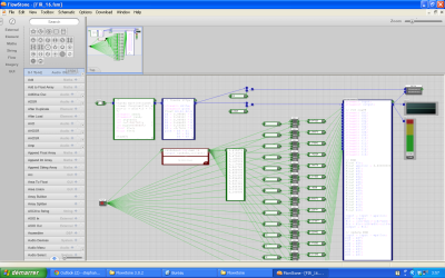

Hello, I'm quite new with Flowstone and I would like to share various experiments using FIRs (Finite Impulse Response) filters.
There is a pink noise as source, grabbed from the old Synthmaker forum.
All FIR coefficients get randomly updated each time you press the trigger (red) button.
The audio output is in stereo, routed to the PC soundcard/speakers.
Left output channel is the unprocessed pink noise.
Right output channel is the FIR-filtered pink noise.
Playing with the left/right balance you will hear a clear difference each time you press the trigger (red) button.
Seems such FIR is working.
Is this a valid framework, for experimenting with relatively short FIRs, say maximum 16 coefficients?
Are there better ways to implement FIRs using Flowstone?
What about longer FIRs? I don't see myself drawing all the required signal lines, for a 128-tap FIR ...
I'd like to rely on the "Text Load" component for entering the FIR coefficients as individual Floats, into the Float array, from a text file residing on the harddisk. Is this feasible ?

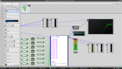

Attached is a FIR lowpass.
- FIR_19 lowpass (400 pix).png (64.58 KiB) Viewed 53595 times

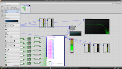

Attached is a FIR highpass.
- FIR_19 highpass (400 pix).png (66.21 KiB) Viewed 53595 times
