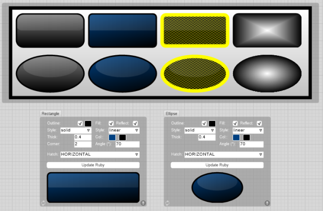

Hello!
Today a was making some GUI in ruby and as a "Lession" i did a port of the old Rectangle & Ellipse Modules from Synthmaker V3 / FlowStone V2
As you see i also did properties for config
What is new is the Hatch-Brush.
If you have any ideas for updates/upgrades please write here
Base-Module - Free4Use in any Project.
For all Ruby nerds - please take a look how i did port all variables from te properties to the main module - maybe there is a better solution - if someone could do that

Re: Rectangle & Ellipse Module in Ruby
@chackl..... may have a little bug...
if change fill style to 'solid'
.no color changes possible.... no hatching either... ??..

nix - Posts: 817
nix wrote:love the hatching brushes mr. Hackl
is it possible somehow to define the size of the hatches?
Thanks
Well i did not find anything - if someone finds a metode i can add it
chackl - Posts: 233
billv wrote:@chackl..... may have a little bug...
Well a hatch allways needs 2 colors
So Hatch is an addition to solid/Linear/Radial.
