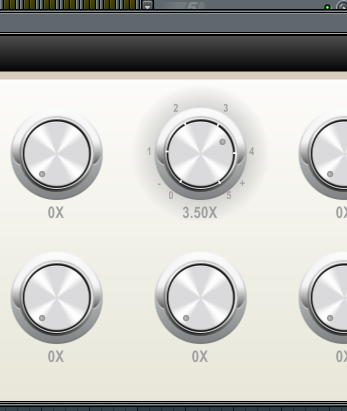

Here's the image of the blank template so far:

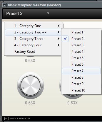

Preset Manager Categories are working but this way:
Category One,<<,Preset 1,Preset 2,>>,Factory Reset

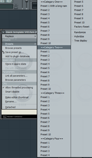

And that works ok for the dropdown, but in the fl studio presets it doesn't, So; I'll do a simple string find looking for this instead:
==Category One ==,Preset 1,Preset 2,Factory Reset
Be sure that these will show up as a preset. I used Ruby to that end; and You can set it to the same parameters as one; Or *argh I might find a way to automatically look for the first preset so that it is a simpler idea.
So, Here's a screenshot of that in action, first the vst's version (click to enlarge):
Now, let's see FL studio's output (click to enlarge):
My code automatically closes the gap and will look for nested accurately too.

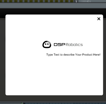

MMk, so; credits and settings: I've made a popup that is easy to use and manipulate for You, it looks like this (click to enlarge):
