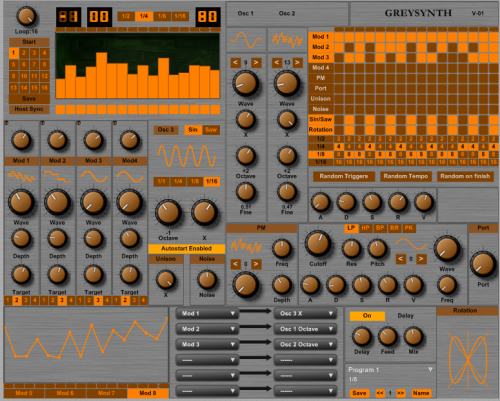

Hey Guys, here's a new toy. Its got a bit of "X11" theme to it.
A basic synth with some mods, routing matrix and automation matrix.
There's 8 presets, so all you have to do is hit the start button. :)
[img]
[/img]
Grey Synth_v01.fsm
(1.48 MiB) Downloaded 1344 times

I was wondering why the Preset Manager didn’t have the usual menu system. Do you rely purely on the DAW’s fxp and fxb system?
Also I feel I should mention that the first preset on loading was just into clipping on my system, but it took me ages to find the master volume control. Maybe it could be separate and bigger…?
This is amazing work and thanks so much for sharing it with us all.

I made that Pre-set manager a few years ago.
It writes and reads to text file so nothing is required by the user.
So , while in your DAW , if you save a preset, it's there when you reload the vsti.
The "stock" preset manager is a bitch :evil: , and does not have this behavior.
