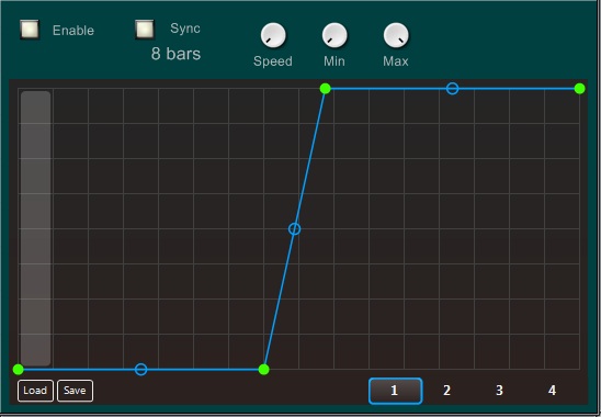

This is a tool that can be used to control other parameters to change in time. You can use it to control volume, filters...etc. Hope it could be useful and maybe someone could find and fix the bugs or come up with something better.
Special thanks goes to TheOm for his beautiful work on Line Editor, and Nubeat7 for his help with position sync.
Known issue: It doesn't always load right, specially in bigger projects, apparently due to ruby's loading problems.
enjoy.

Sweet, got it working , anyone have an idea how i can resize this thing ?
Any attempt will crop the grid which makes it work wrong.
Re: Advanced Envelope
Hi! To resize it, just resize like a normal module and then press double click on "line editor" to resize it. (Sorry for my bad englishlalalandsynth wrote:Sweet, got it working , anyone have an idea how i can resize this thing ?
Yes, but now you have 12 grids instead of the needed 16 .
It does not work properly like that.
