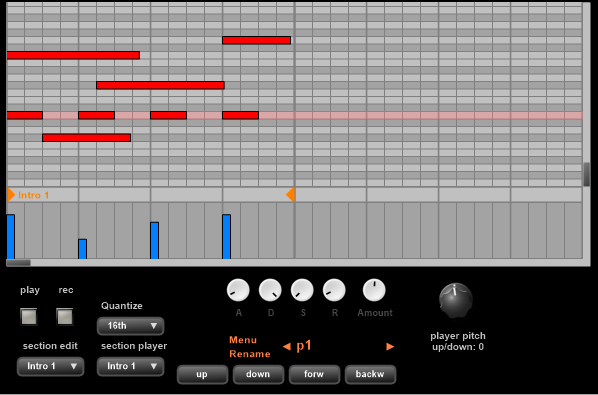

i did a sequenzer for kortezzz in ruby and during the development i ran into the same issue, so i changed the concept,
instead of saving every possible note event on each notenr, which is a lot, i save only each note which is drawn and limit the possible number of notes you can draw to a useful value (in my case i think it was 600 notes in 6 sequence sections or so) - dynamic sized arrays would be so great here
the trick is to save a note event in 4 arrays, one array for the lenght, one for notenr, one for the position in time and one for volume, like this you can reduce the preset arrays to 4 arrays with the max number of notes you want to allow
in your case you have a global notelenght so it would be one array less..
but this would need a big rewriting of the presetsystem and there should be something when the maximum of used notes is reached
here is a picture of the sequencer
- seq1.png (20.63 KiB) Viewed 32745 times
