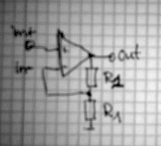

Consider the analog non-inverting amp schematic below. The system behavior is determined by the op amp free running gain and the feedback topology. Thus, the op amp output is given by
where in+ is the voltage at the non-inverting input and in- is the voltage at the inverting input. The latter receives a fraction k = R1/(R1 + R2) of the output voltage,
Substituting this expression in the first equation we obtain
What happens if we apply some nonzero voltage to the non-inverting input? The output will respond immediately, however since a fraction of the output is fed back to the inverting input, the response will not be with the full free running gaing. We can actually compute the resulting loop gain by solving for out,
the second equality being a high-gain approximation.

out = gain*(in+ - in-)
in- = k*out
out = gain*(in+ - k*out)
out = gain*in+/(1 + gain*k) = in+/k
