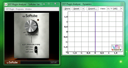

Re: ->Analog Saturation<-
Hi ... I analising Softube saturation knob ,,, got here such evidence ... quite interesting, it will be necessary to work with the assembler that it would happen ... probably
- SK Test.gif (50.68 KiB) Viewed 34017 times
Are you controlling the level of 'Harmonics' ??
