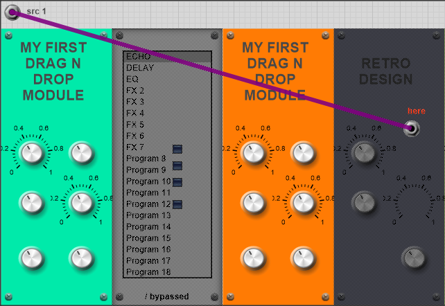

Postby hardwarehost » Mon Nov 23, 2020 7:32 pm
One cable was successfully implemented in the rack
-houston? -what... problem? -no, did you see that? :shock:
