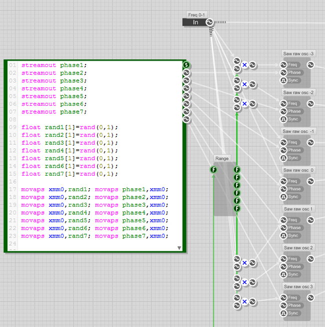

Cool, im glad you found my little paper userful! Sounds pretty cool! I checked your schematic and you are using a way too complicated method for the phase randomisation. You can use assembly to same a LOT of cpu for this task. This is how I did it in my synth

- random_phase.jpg (304.93 KiB) Viewed 34780 times

adamszabo wrote: I checked your schematic and you are using a way too complicated method for the phase randomisation. You can use assembly to same a LOT of cpu for this task. This is how I did it in my synth
Thanks Adam! Glad I said your name right too.
I tried various schemes for the phase randomisation but I found that whenever a channel opened (note pressed) I got the same random numbers every time. In the end my scheme was based on 6x free-running (mono) white noise modules (thanks Martin!) with different seeds converted to poly and then I always get unique spreads. Could you tell me whether your scheme will always start with a unique value set from those rand functions?

Spogg, yes, try it out! You get a different random unique number from each output everytime you press a new key. Connect a white readout primitive to it and you can see it.

Thanks Adam, I will try it in the near future and check the CPU saving.
I must assume that the RAND function is somehow invisibly seeded so that when the channel is opened you don't always get the same result. Fascinating!

The CPU dropped to nearly half with your asm code
I've put the new version 1.03 as the Dropbox link on the first post (and on flowstoners) and recommend folk download it again due to the CPU saving.
Adam, I made this work easily in DSP too (slightly higher CPU) but when I checked there is no reference to the rand function in the manual. This annoys me a bit because, had it been available I would have used it. Since there is no info there is no syntax for its use either. Could you possibly explain why we need to create a Float Array for the rand function and not just a regular float?
float rand1[1] = rand(0,1); This works
float rand1 = rand(0,1); This doesn't work.
Also can I put any upper and lower limit in the brackets?

Unfortunately, I am not an expert at that code, I just got it like you did from me, but to my understanding, we have to create an array to fill it with the random numbers. You can also call that variable MyRandomArray[1] if you want, it does not have to be rand1[1]. The 1 in the bracket means the size of the memory, I think 1 means 4 bytes or something? Also, yes you can put other limits in your brackets. (-2,2) will do the random number between -2 and 2.

The rand() function is mentioned on page 242 of the User Guide. Apparently it may be used to initialize an array with random values.
