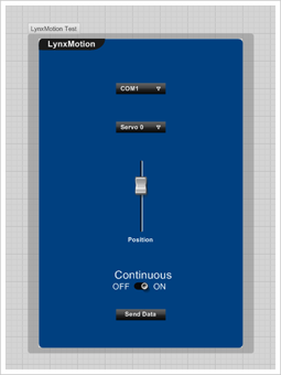

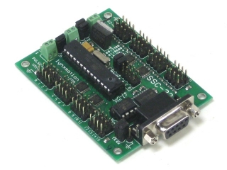

This is an example project to control the LynxMotion SSC-32 Servo Controller. This servo controller is used on various LynxMotion robotics products.
In this example there is a drop down menu to select the correct COM port (This can be found in the Windows Device Manager) and another drop down menu to select the servo number (we have addressed only the first 8 however there are 32 to choose from). Then there is a slider to set the servo position and a Send Data button to send the new position to the servo. In addition there is a continuous mode if you want to send the position in real time.
