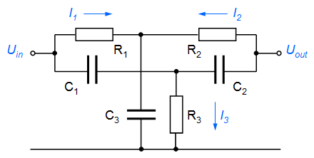

Here is a little excercise inspired by BobF: a digital implementation of a double-T-filter. In the analog days this was a popular notch filter, primarily for its robustness wrt component tolerances. The schematic below is a direct implementation of the corresponding nodal equations using an explicit Euler scheme. Nothing of a big deal really, but I thought I'd share it anyway.

After playing with this for a few hours (too many), can I change the resistors and capacitors to any value that would work in the hardware world or are there high and low limits on this one? If I can change values does dt also need changing? What is dt for, damping or ?

dt denotes the time step and is a constant equal to 1/samplerate. You can try out other resistor capacitor values as long as the RC time constant is large compared to dt. You could stretch it a bit further by replacing Euler with a more sophisticated ODE solver but if the system characteristic frequencies exceed Nyquist the only remedy is a smaller time step (oversampling).BobF wrote:can I change the resistors and capacitors to any value that would work in the hardware world or are there high and low limits on this one? If I can change values does dt also need changing? What is dt for, damping or ?
