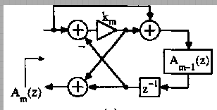

I find another allpass type that could help. Not specially for the SVF but for filter based on allpass..
With this one it's possible to modify some instruction and we get easily in+allpass or allpass-in.
This help to remove 2 instruction.
But for one or the other result the modification are different so we could not get the 2 result..
Also it will be more convenient to get in-allpass, but the result is just the inverse.
Seeing the image you would see how, the arrow that go back down could be attached latter.
Allpass for difference.fsm- (43.06 KiB) Downloaded 1896 times
