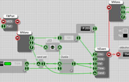

I made a schematic but it bugs.
I thought it would be great if i could do such a thing as i'll explain:
"Get time position and beat offset and according to the position of each not that is inputted, fit it to grid and if it's earlier, double-tap, if it'S even earlier, tripple-tap".
I'll show you what i've done yet, and i assume it'S probably way cheaper than what you would've imagined.
I use a time-fitted ticker in which i added some non-sync bpm division making the ticks somewhat, at least match the speed if not the sync.
I guess there's something wrong with note-off... Or something.

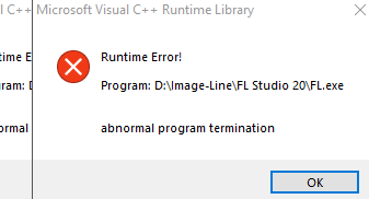

The more it runs, the more likely it is to send "c++ error" messages and crash FL Studio.
For the moment, the plugin runs like this:
I input imitone midi output as P1. I input it in the plugin as P1 and output it as P255 (Could be P2, there's a selector).(Oldschool pre-ruby prims made, like the old days)
Ticker emits a note at default pitch through the few midi modules, by some wizardry.
Notes also passes through, but like i said, i'd like to be able to manage the notes, stack them to the closest time division and use the time-difference as a way to make multiple-taps and somehow play drums with an arp later in the midi chain, outside synthmaker. That's why i want to fill time. And also to control vocoders!
But before i'm even there, i need to figure out how to prevent those c++ error prompts. If i catch one anytime soon, i'll EDIT and "Quote" it.

- schem.png (33.14 KiB) Viewed 44177 times

I'm still trying to make something out of this.
The error i get is "this". Every note played adds another pop up.
It happens when receiving notes through midi from imitone.
