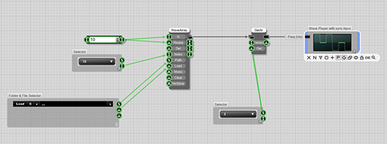

a right i think i get you! you want multiple IR waves to be stored and a way of retrieving them? you can do that by populating a wave array!
here i have set up a ten wave array to demonstrate what i mean! to populate the array you just load a file into each index and then use mem get to retrieve the wave at a given index! just remember that arrays start from 0.
i.e 0,1,2,3,4,5.......
here is an example
array.fsm
(53.37 KiB) Downloaded 1498 times
hope that helps!
