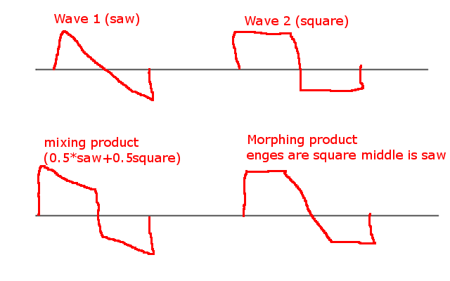

In cross-mixing means that the wave=x*wave1+(1-x)*wave2;
Morphing means changing shape from wave1 to wave2 but not necessarily by mixing the two waves - morphing is wider term.
Image below shows mixing product 50/50 of the waves and a morphing product calculates as beginning and end of waveform= square and middle = saw. This is just one way to morph between waves.

Guys, thank you very much! I now see my fallacy. There's of course a difference between time domain and frequency domain, which I totally ignored.
I think I understood. Hopefully...
Yes, the math is also known as "linear interpolation"KG_is_back wrote:In cross-mixing means that the wave=x*wave1+(1-x)*wave2;
That was very helpful! I'm a visual guy. ThanksKG_is_back wrote:Morphing means changing shape from wave1 to wave2 but not necessarily by mixing the two waves - morphing is wider term.
