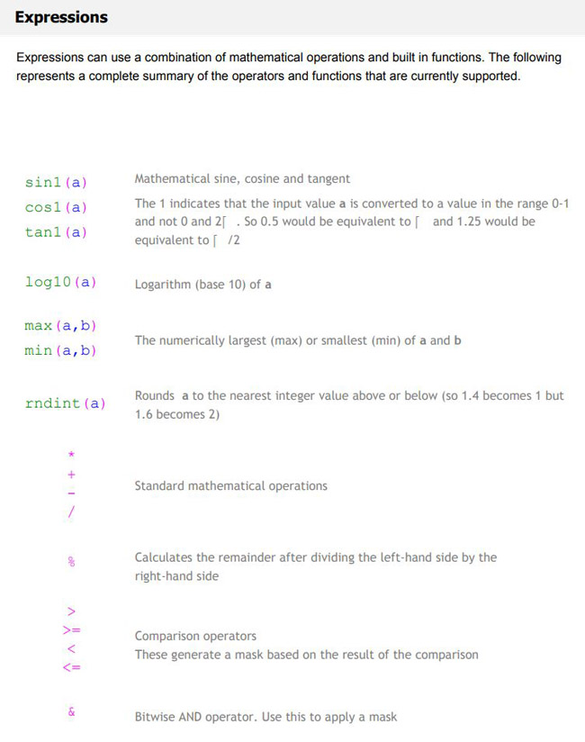

Postby steph_tsf » Fri Feb 21, 2020 3:27 pm
I am attaching a .fsm and a .jpg, for asking what's the specification of the sqrt(x) function that's supported by Flowstone 3.0.4. The .fsm shows that the the sqrt(x) DSP Code Component function doesn't deliver the square root of the input. Have a nice day.

Postby steph_tsf » Sat Feb 22, 2020 1:38 am
trogluddite wrote:the only advice we can offer is to send an email to support@dsprobotics.com reporting that you can no longer upload, and hope for the best
Without doing anything, without sending an email, I am again allowed to attach files. The attachments are now on my post, above. The sqrt(x) doesn't deliver what one is expecting. There must me something obvious like an offset, or some rescaling. Can you please tell?
