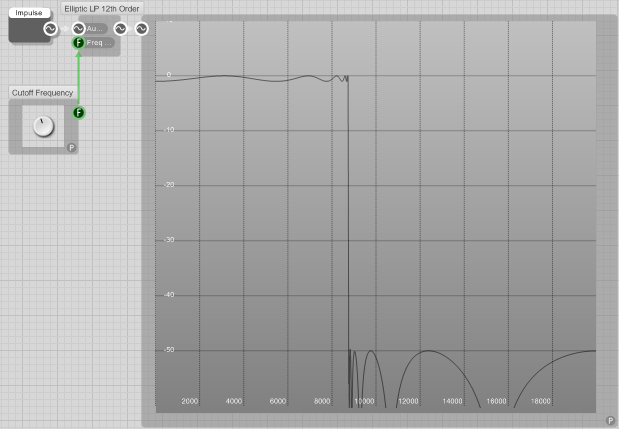

Here is a tunable 12th order elliptic lowpass as an example:
EllipticFilter.fsm- (14.24 KiB) Downloaded 1806 times
