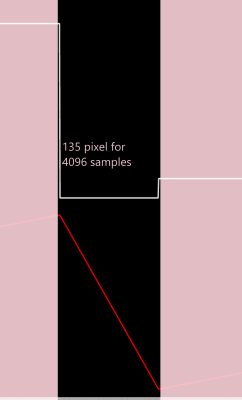

Careful! By comparing it through a scope, you fall to a trap.
The scope only display a few pixels, not nearly all incoming samples. Imagine it like a hop as well. In reality the line will either not look that linear, although better than the staircase, or the dsp module IS calculating each sample instead of only each 4096th.
Also, your code ignores discontinuities. The saw wave would start at -1, after having reached +1. So the two samples at that position would read +1, -1
Your code introduces a delay of 4096 samples, before -1 is reached after +1
Not sure, if these are important points, but they are for sure existing, and I don't think they should be ignored

Yes, some valid observations. I remember noticing the accumulating error when I first devised this ... that'll be rounding errors, that will
Only suitable really for use with poly stuff anyway, where such errors won't be of significance because you don't hold keys down for 10 minutes. (Omg you don't, do you ??) I made yesterdays demo in blue just because it's more forum-friendly that way (- no complication of MIDI keing or anything). Same kind of code.
Nor would I choose to use it with hop(4096) .. ditto! In practice I've used it with envelope code at (64) or (128), where any sample lag, compared with exponential methods, tends to be insignificant.
Btw one other disadvantage of slew-limiter maths is that it can lead to Denorm cpu log-jams ( .. see elsewhere), I can't see that happening with linear interpolation.
