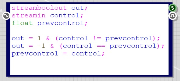

But, seems that my snippet for syncing oscillators on incoming stream-changes don't work at all in 3.09 beta :(
Pretty critical simple function for the synth.
DSP snippet for syncing that doesn't work in 3.09 beta
Anyone have an alternative DSP snippet that does the same but works in 3.09 beta by any chance?
Maybe it's done completely wrong.
Posted: Wed Aug 17, 2022 2:39 pm
by Spogg
The issue is you’re supplying streamboolout as a numerical value rather than True or False. You can get away with that in green but not DSP. In the green world True is the same as 1, but not in DSP.
The line should read
out = (control != prevcontrol);
This may not need brackets in this instance but whatever…
The expression will either give a Boolean True or False which can be used elsewhere in DSP when a proper True/False Boolean input is required.
CODE: SELECT ALL
Awesome thank you Spogg!
I'll try that out and see if it works in 3.09.
My old faulty one worked in 3.08, probably a fluke...
