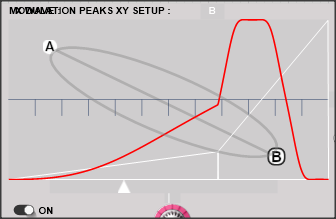

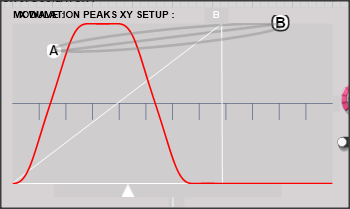

As I see it, on the picture is tri. osc multplied by 3 and streamed only in -1 to 1 range, min/max. If sub. or add value 1, it will act as phase shifting. I dindt take in depth look but I was working on something similar so its my association... The MIX controler between this X3 wave and before state should do the dashed lines on the picture.

The level increase from 0 to max is one phase of osc. finished - same as level control . The wave design is here described as output levels of two operators at increasing settings of the Level control
Simply: plug the level into phase and you need the wave - and thats the whole of what i wrote about.
You see on my picture the pretty close match.
The misunderstand was in modulation between the the two in whitch I am interested. If its not there in the real synth, than for emeulation its useless.
