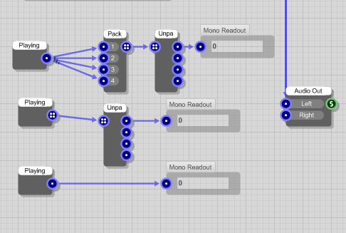

Yeh nubeat7...there defiantly seems to be a bug there somewhere....
In the meantime, here's a way of working around it that might help...
I'm testing in FL....
Nothing works in this pic....
Then, for some reason, just drop this into schematic..
And everything works....
give it a try with your fsm...weird...

I didnt clarify this...but dont connect the green/ruby
prim...just drop it into schematic un-connected..
and still use the blue.
